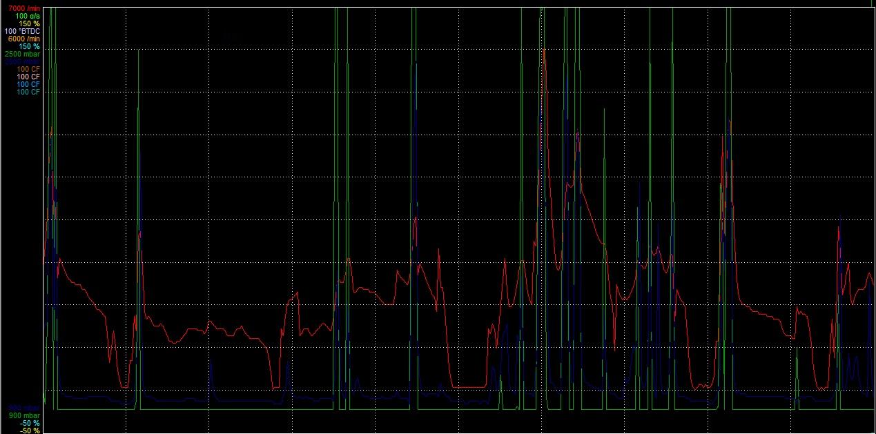

  3. Will edit soon, new layout; Main torque maps in the ecu's, KF (kenfelder - map, M - moment/torque) - are KFMIOP and KFMIRL - essentially the main torque maps for the central torque monitoring ecu's - some locations and info (to be edited); Note - 022906032 is the usual ecu number for ME7.1.1. - BG is the commonly used BDE code between tuners, 032E is the one often used for AUE none twin vvt ecu's, will update with more info when needed; BDE v's a tuned HX35 turbo AUE; Notice how the AUE turbo has IOP modified to be maxxed at any load
