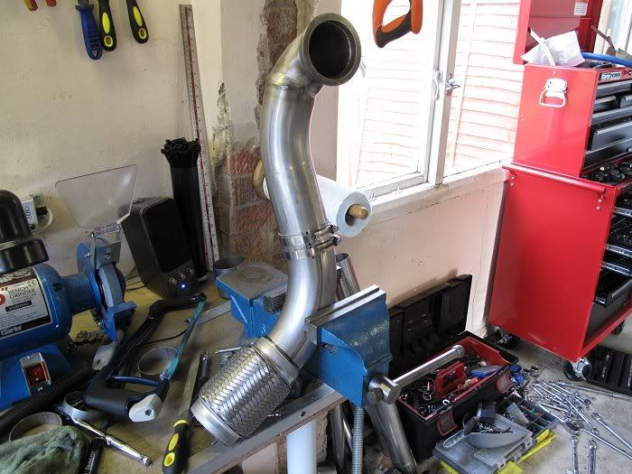

Made a bit more progress....
Downpipe's coming together. This is the shape you're aiming for with the ATP. From the top' date=' I used a tight 90, 30 degree section, then a 90 degree and finally a 3" Ilok flex. All from Jetex.
[img']http://i182.photobucket.com/albums/x2/kevhaywire/ATP_downpipe1.jpg
Kev, i know its an AGE ago... but is that definately 90, 30 then another 90? last piece looks too shallow, maybe a 60?
