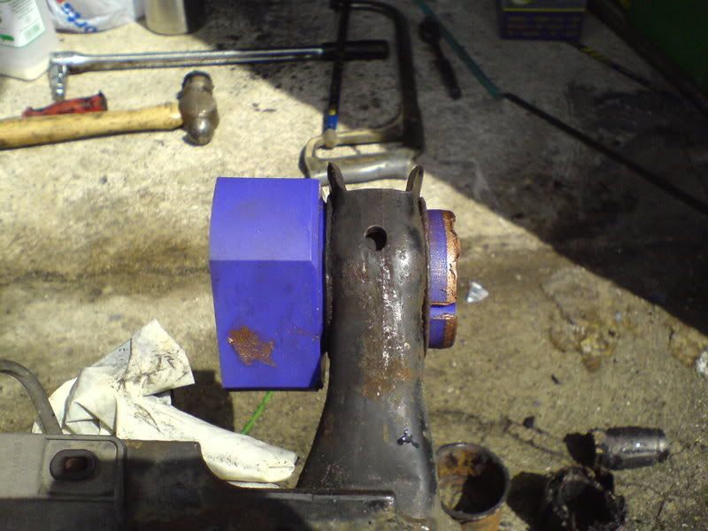

Yes when i burnt the old rubber out i went in with a hacksaw and cut the steel outer.
They fit in the beam ok, and will fit in the bracket on the car, but when in the beam they wont go!

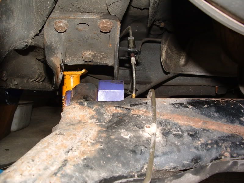

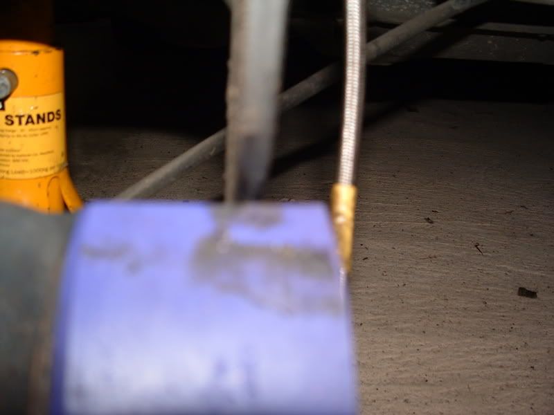

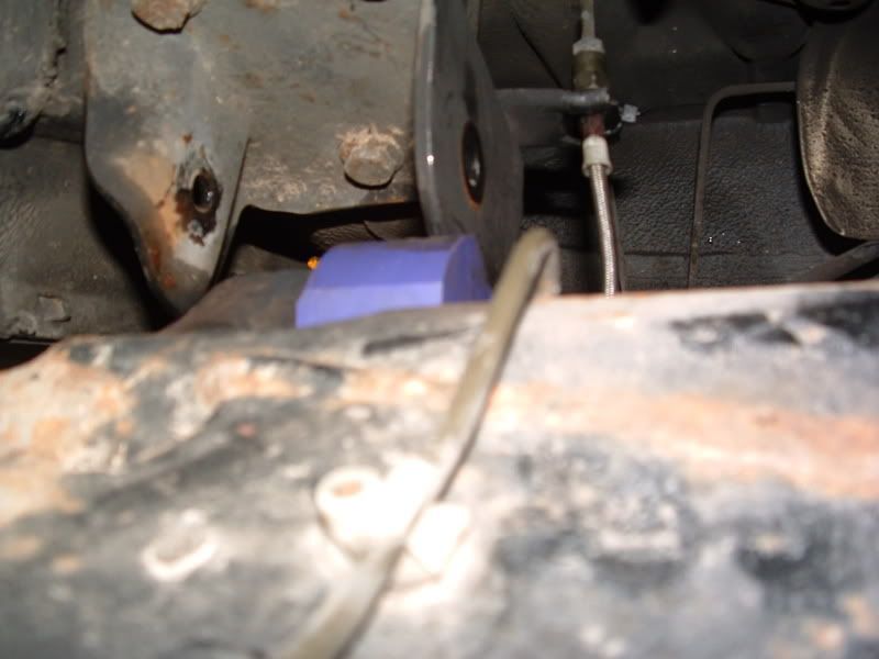

Here are the piccys..
As you can see with the other side in the bracket this side is out by what 8 - 10mm.....

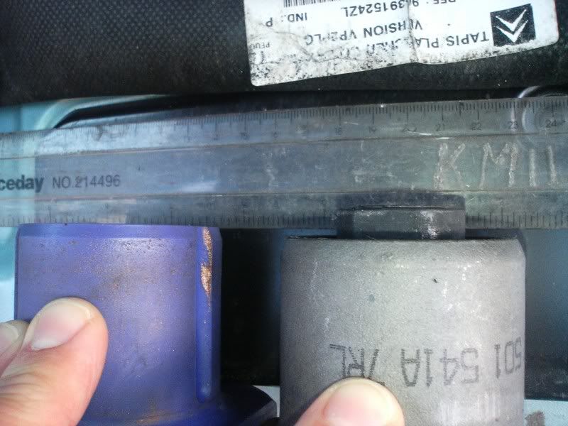

Here is a standard bush compared to the powerflex one when the radi are lined up, you can see the difference in height.
The bushes are the same overall length but where the radius starts is different.
This one show the difference in where the radius starts when the bushes are placed on end next to each other.
