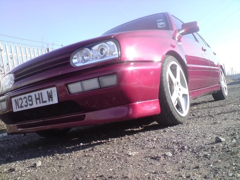

2 weeks ago i bought a set of wheels off ebay and put them on . the tyres are 205/40/17 . car now looks like this and i love it
[img:width=600]http://img.photobucket.com/albums/v349/woodz77/DSC00210-2.jpg[/img:width=600]
now the car steering is lighter . went to the local tyre place and he said thats normal on a lot of cars ??
the car now slides in corners as if your going to fast into the corner and even though your turning the wheel it still goes straight and then turns if you know what i mean ? its like when its wet and you go round a roundabout and if you give it well a car will pull out further even when steering in course the weight of the car is pushing it out and the tyres aint gripping enough till you let the power off ?? if you know what i mean . its a strange one to discribe . it aint that bad in the dry but still handles like its on thin 14 inchs steels ?? im trying as best as i can to decribe what it does ???

Crap tyres I would say... but less deflection of the tyre wall due to then being thinner would make the car handle slightly differently.

Crap tyres. I rotated mine around. I had Falkens on the front and cheapos on the rear. Because i wanted to get rid of the cheapos i put them on the front. I reckon another month and they'll be fooked. The handling is terrible with them on the front compared to the Falkens. Im scared to go around corners any faster than 10mph! :P
I totally agree - the VR needs good make tyres all around - it can have 7-10mm of tread but if they r micky mouse tyres then they wont be able to cope with the weight and set up.

Tyre preasure - make sure they are correct all around.
Other thing is Camber - you car looks lower and on 15's the camber setup might be correct but on 17's the cam angles might be altered.
This is the biggest problem with lowering cars - people forget to get the alinement setup aswel.

As said above check your tyre presures, Sound like there under infalated to me. It will handle better on 15-16 but if you got some wide 17s and got it as low as it was on the 15s if not lower then it shouldn't be much worse.
But it also sounds like the cheep tyres.

Dont matter what size your wheels are camber is camber, Just get it set to the factory settings, its know different how low it is ect. They wont be able to do the backs tho. Only way to do the backs is by chamber plates put behind the sub axal but its not leigal

chers mate . thats worth knowing definitly . going to buy a new lowering kit i think and 2 front tyres and go from there .
