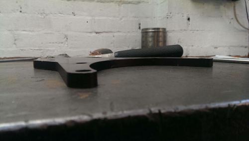

VR6Pete 1,455 Posted November 24, 2015 Author Report Share Posted November 24, 2015 Soooo. Plate now nice and straight again. Should have it back tomorrow so can get things fitted up again and measure what belt I need Link to post Share on other sites

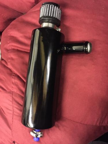

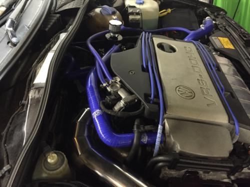

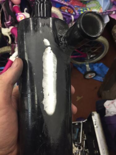

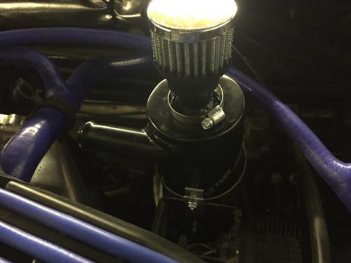

VR6Pete 1,455 Posted January 12, 2016 Author Report Share Posted January 12, 2016 Happy new year!Now that I have money again I'm back on to the build!Had to buy some 90 degree AN fittings and some more hoses, fittings etc....Also came up with a solution to mount catch can:Clamped it to the metal bracket between 2 metal plates. No messing. Sent can off to get powder coated again as had to file off the bracket on it. Also ordered up the pipe work I need to connect it all up. Air filter arrived today!Pretty good quality and nice small enough not to have to worry about it being too low to the ground once fitted. Bealieboy, cactusjackslade and daveyboy 3 Link to post Share on other sites
c00k 435 Posted January 13, 2016 Report Share Posted January 13, 2016 (edited) Looking good buddy, are you running the MAF after the charger then? Or you going MAFless? Almost mounted my catch can there, but after looking at the hose route, and wanting to try and hide them as much a possible. I went for it on the bulk head, next to brake servo. Getting there man! Going to amazing with you freshly built engine too! Edited January 13, 2016 by c00k Link to post Share on other sites

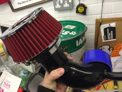

VR6Pete 1,455 Posted January 14, 2016 Author Report Share Posted January 14, 2016 Looking good buddy, are you running the MAF after the charger then? Or you going MAFless?Almost mounted my catch can there, but after looking at the hose route, and wanting to try and hide them as much a possible. I went for it on the bulk head, next to brake servo. Getting there man! Going to amazing with you freshly built engine too! I will be running a MAF before the charger. I cheated a bit with the photo as my MAF needs to be further away than 18", so have some flexible tube etc.. on order, so will have it all neatly hidden away behind the wing / bumper, I didn't want a massive filter as most I see have a filter almost on the floor, and when the weather is as good as it in the UK I wanted something further off the ground. I've got the pipework on order from ASH, with a 90 degree reducer (20 > 25mm) and shouldn't look too bad with how I have it planned. I cannot wait to get it going, but worth taking my time and doing it right first time Have you replaced your small idle pulley mate.As I have and idea of one that may work.It's from a Subaru, I saw it on something I was watching, and thought straight away they could be used on VR superchargers.http://shop.grahamgoode.com/subaru-impreza-classic-small-timing-belt-idler-pulley-ggs3028-64860-p.aspSomething abit like this, the rear could be milled, cut down, or even spaces.If it will definely work I'm unsure, but it's an idea. I think with a small bit of fiddling and adjusting it could work very well. I already have a dual idler pulley installed, so shouldn't have many/any issues with belt slip etc.... I'm sure I did see that pulley on the supercharging the mini series ! Sure they had that exact one lol! Link to post Share on other sites

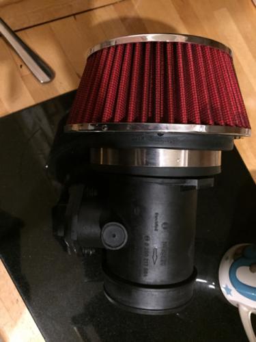

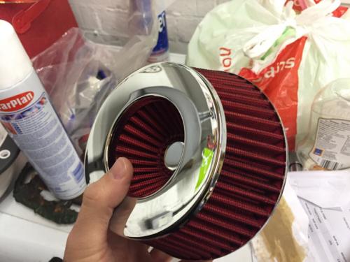

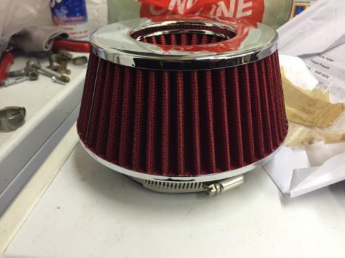

VR6Pete 1,455 Posted January 15, 2016 Author Report Share Posted January 15, 2016 Decided to get the filter mounted to the MAF.The diameter of the filter was 76mm, but with some boiling water it went on nicely. Photo below shows scale more clearly. dom.joy, cactusjackslade, daveyboy and 1 other 4 Link to post Share on other sites

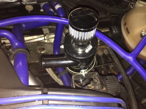

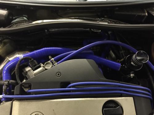

VR6Pete 1,455 Posted January 19, 2016 Author Report Share Posted January 19, 2016 So. Catch can is all sorted now. Feel like I am making progress. Had it powder coated in gloss black. This is how I'm mounting it to the can. Hooked up the pipe work and mounted it all up tonight. It's turned out pretty well. Just need clamp the hoses up and another job off the list D11PS, cactusjackslade, c00k and 2 others 5 Link to post Share on other sites

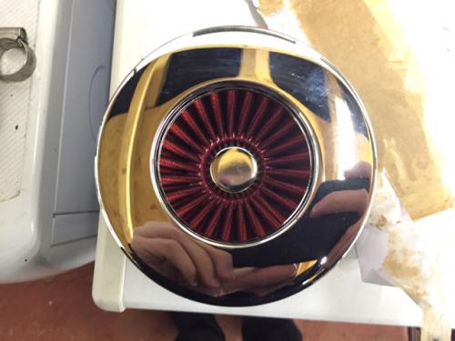

Daverse 175 Posted February 20, 2016 Report Share Posted February 20, 2016 What size is that air filter? Could just be the angle but it looks huge Link to post Share on other sites
VR6Pete 1,455 Posted February 20, 2016 Author Report Share Posted February 20, 2016 What size is that air filter? Could just be the angle but it looks huge It's actually quite small compact. Think it's around 2.5" didn't want anything that was massive and hanging down near the ground with the British weather! Link to post Share on other sites

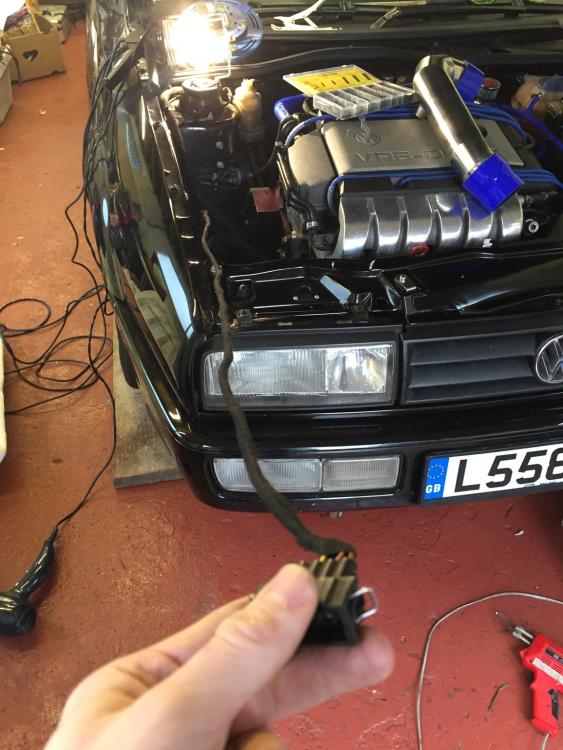

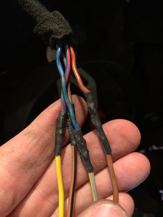

VR6Pete 1,455 Posted February 21, 2016 Author Report Share Posted February 21, 2016 Had some time today to sort the MAF wiring out. Not the best of starts as the soldering iron packed up do had borrow one off neighbour. Anyway, soldered, heat wrapped and and cloth taped up the loom ready for charger installation. Another job off the list. Next up is to measure my belt length, but like my tools my ball of string has gone missing too so couldn't do that today. Still need fit fuel pump next weekend.... bennyk, c00k, daveyboy and 1 other 4 Link to post Share on other sites
