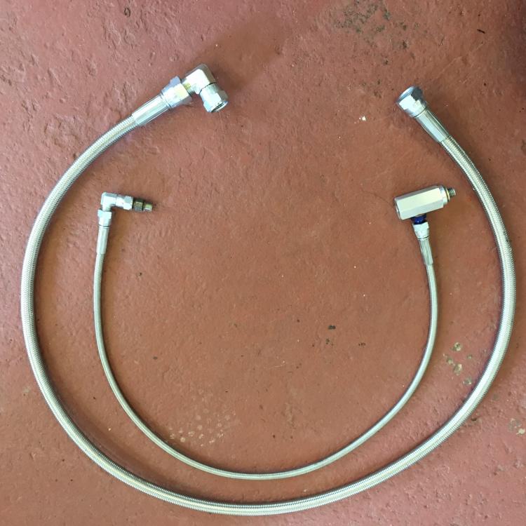

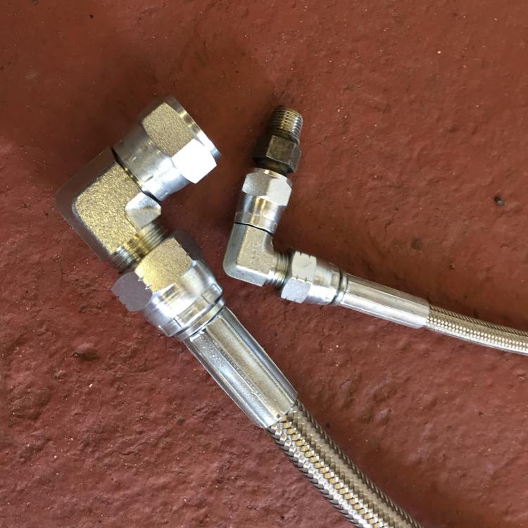

VR6Pete 1,455 Posted April 23, 2016 Author Report Share Posted April 23, 2016 Went to my local pirtek branch to make up my oil lines as didn't have correct tools here to do the job and wanted peace of mind 🏻 They have done a great job and only £38 - I supplied the lines and they supplied fittings. cactusjackslade, bennyk, daveyboy and 3 others 6 Link to post Share on other sites
c00k 435 Posted April 24, 2016 Report Share Posted April 24, 2016 Nice man, braided hoses are much better There not to hard to make your self, with slight different fittings. You could of made them with a vice, AN fittings, and a spanner. It's not to hard, I've made loads for my air ride, external oil cooler, power steering. VR6Pete 1 Link to post Share on other sites
VR6Pete 1,455 Posted April 26, 2016 Author Report Share Posted April 26, 2016 On 4/24/2016 at 9:20 AM, c00k said: Nice man, braided hoses are much better There not to hard to make your self, with slight different fittings. You could of made them with a vice, AN fittings, and a spanner. It's not to hard, I've made loads for my air ride, external oil cooler, power steering. I didn't even have a saw to get a clean cut and after stabbing under my nail with a piece of braided hose it wasn't worth my time for the sake of 38 quid, piece of mind as well knowing they have been done right too Link to post Share on other sites
c00k 435 Posted April 26, 2016 Report Share Posted April 26, 2016 (edited) I know the feeling of being stabbed by them. Also don't cut braided hoses with a saw buddy, all the end's fray like mad. Even if you do tape it up. Use a decent pair of heavy duty snips. Or a braided hose cutter. Thats how I cut mine anyway, I learnt not to uses a saw after making my first one. Edited April 26, 2016 by c00k VR6Pete 1 Link to post Share on other sites

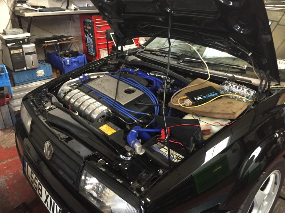

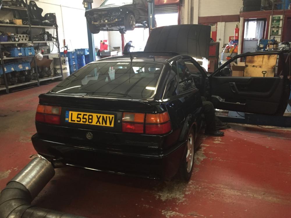

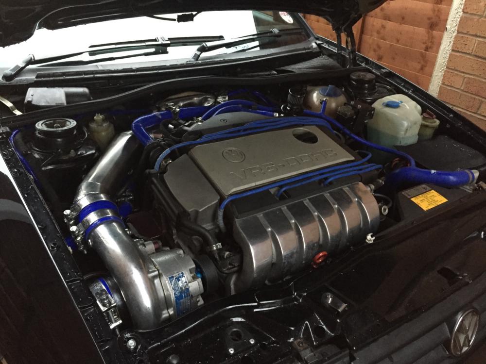

VR6Pete 1,455 Posted June 10, 2016 Author Report Share Posted June 10, 2016 Sooo. Has been a few weeks since having it up and running. Seems to be running well. Put it on the rolling road at stealth on the last rolling road day just make sure everything is looking good in preparation for my mapping session on Monday. Everything looked well and was pushing 9psi boost, should be 10 - 12 PSI though. Noticed not long after the case was leaking boost where the scroll meets the gearbox housing on the charger. Ordered some jointing compound which has sealed it up nicely as well as replacing the 6PK belt for a much better quality 7PK belt should see me hit the numbers ! Have also installed plastic splash guard to help protect my air filter. Fitted decat but got a blow because of a crap clamp so will be sorting that tomorrow. It's had a good clean too ? VR6 Supercharged, Bealieboy, bennyk and 2 others 5 Link to post Share on other sites
matty.vrt 120 Posted June 11, 2016 Report Share Posted June 11, 2016 Looking good. What are you hoping for numbers wise on Monday? VR6Pete 1 Link to post Share on other sites

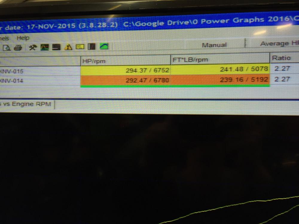

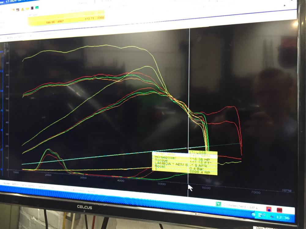

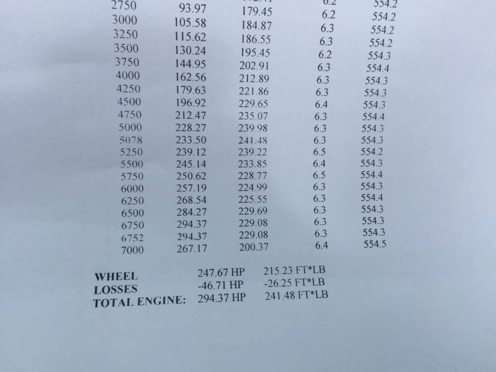

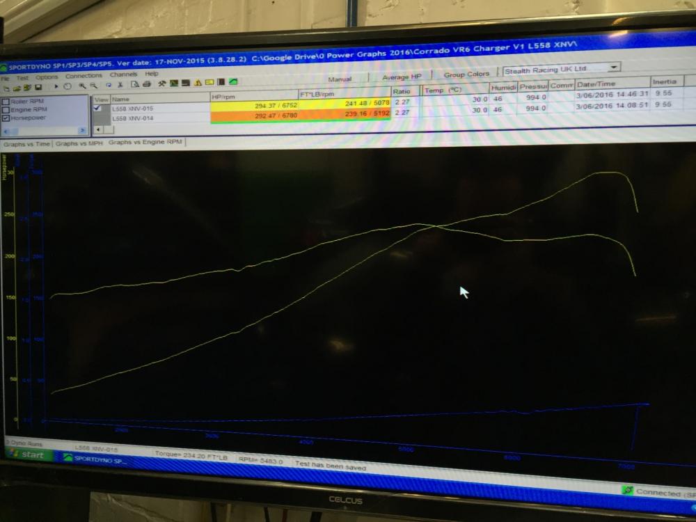

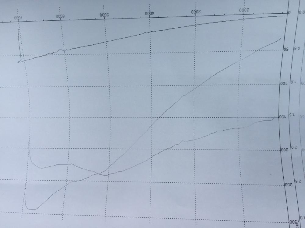

VR6Pete 1,455 Posted June 14, 2016 Author Report Share Posted June 14, 2016 I went to Stealth yesterday, feeling quite apprehensive! I am the 3rd car that has used their new strapping system, so they can run higher power cars without needing to use glue all of the time, and all went well. Be interesting to see how John Maliks 800BHP + corrado gets on when its back on the rollers Anyway, back my car...early on the mapping session it appeared to have a misfire after 5,000 RPM which put a stop on the session, ended up being spark plugs as engine has been overfueling and plugs were pretty shot ! Vince has recommended FR7KPP33+ - so we could continue the session just swapped for some old NGK's he had around the workshop. Started to hit the numbers after Vince worked on the map, 262BHP, 279BHP, 292BHP and on the final run pushed 294BHP ! Was really happy with the outcome and im sure it will do more as was a fairly hot engine by this point - The drive home was immense and bags of power on boost now ! Just need to get some plugs and away we go! Will post up some photos shortly! 294BHP and 241 lb/ft @ 0.6 bar isn't too bad for the old girl cactusjackslade, D11PS, VR6 Supercharged and 2 others 5 Link to post Share on other sites
c00k 435 Posted June 14, 2016 Report Share Posted June 14, 2016 (edited) There the same spark plugs I run vince recommend same one for my charger setup. They do make the engine run hotter than NGK's, why I have and external oil cooler, with a thermostat, so it can never over cool the oil. Plus an alloy oversized and uprated rad, low temp thermostat, and low temp fan switch. But with your engine being almost brand new condition, I'd run an external oil cooler, with a thermostat. Plus a low temp coolant thermostat. Sound like you made some good figures. What at has been done altogether? I known a brand new 2.9 long stroke engine rebuilt by Vince, supercharger, walbro. Just like to know to compare it to mine and get rough ideas of figures. Edited June 15, 2016 by c00k VR6 Supercharged and VR6Pete 2 Link to post Share on other sites
VR6Pete 1,455 Posted June 14, 2016 Author Report Share Posted June 14, 2016 Misfire woes: VR6 Supercharged 1 Link to post Share on other sites
lilfuzzer 48 Posted June 15, 2016 Report Share Posted June 15, 2016 Any ideas as to what's causing the misfire mate? Link to post Share on other sites
VR6Pete 1,455 Posted June 15, 2016 Author Report Share Posted June 15, 2016 4 hours ago, lilfuzzer said: Any ideas as to what's causing the misfire mate? sh1t plugs Link to post Share on other sites
