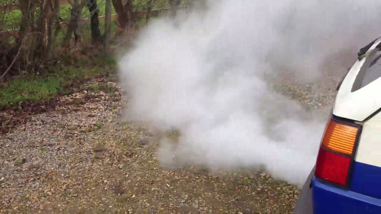

J5KE F 0 Posted November 26, 2011 Report Share Posted November 26, 2011 I just done this.. Didnt think that the car was up on stands at the front.. Put another 5 ltrs in.. And yep white smoke heaven....Drained it off now but its still smoking like an essex girl on a friday nite.. (sorry nat )And a nice little vid http://i282.photobucket.com/albums/kk273/jakefronda/neenaw/0498890f.mp4 Link to post Share on other sites
Biggazvr6 0 Posted November 27, 2011 Report Share Posted November 27, 2011 I bet that smells lovely! Link to post Share on other sites
