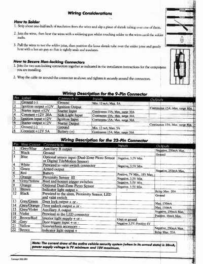

VR6Pete 1,455 Posted December 5, 2013 Report Share Posted December 5, 2013 Mmmm sounds like it's been badly fitted! I had a single wire that had cut as it was fitted so bloody tightly! It controlled the central locking pump which I was having issues with my full closure. I'll try and get the wiring diagram for the concept 300 and you can then see what the brown wire is for. I know that the concept is usually hooked up to the indicators to indicate armed / disarmed so could be something not wired up properly! But sounds suspect just having a random wire there! Club Chairman Link to post Share on other sites
Jimmysan 0 Posted December 6, 2013 Author Report Share Posted December 6, 2013 Aha, I've found this http://www.eserviceinfo.com/preview/Clifford.Concept.300.Wiring.gif thanks Pete for the pointer, indicator feed is brown! sounds promising! Will report back after trying to sort this tonight Thanks Link to post Share on other sites
Jimmysan 0 Posted December 9, 2013 Author Report Share Posted December 9, 2013 Pulled the clifford box out, won't go into detail but I've bypassed the immob and car is cured. Got to decide what to do know, don't want the immob/alarm but then I'd loose remote locking? I can't work out where the loose brown cable goes, traced other end back to the earth point for the fuse box on the door pillar, but seems like an add-on Link to post Share on other sites
