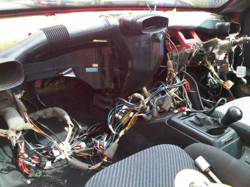

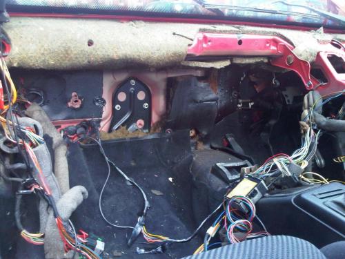

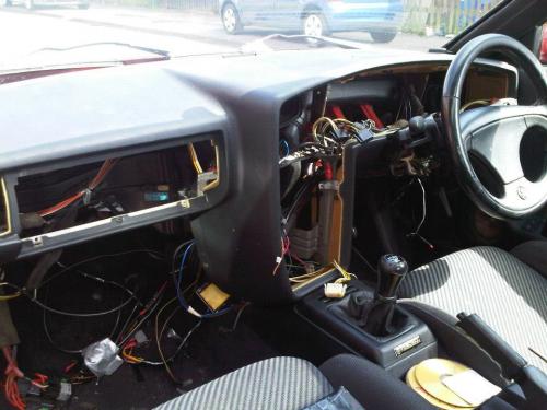

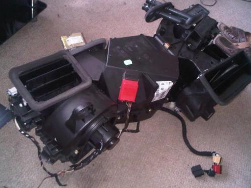

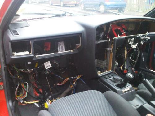

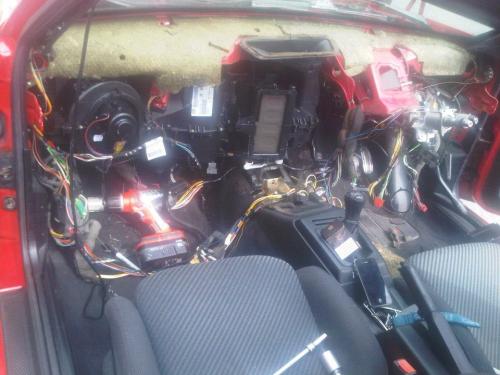

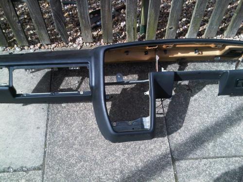

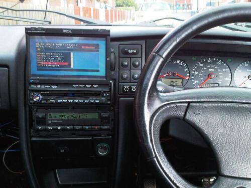

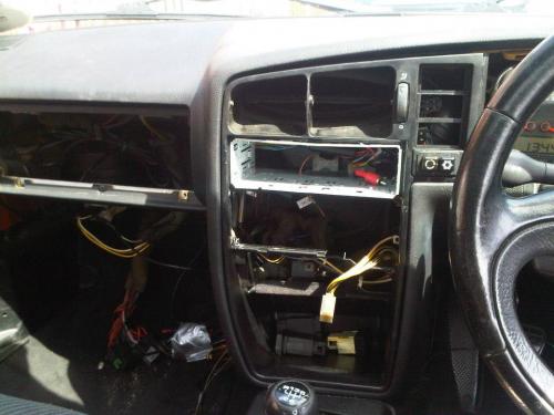

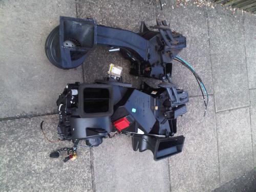

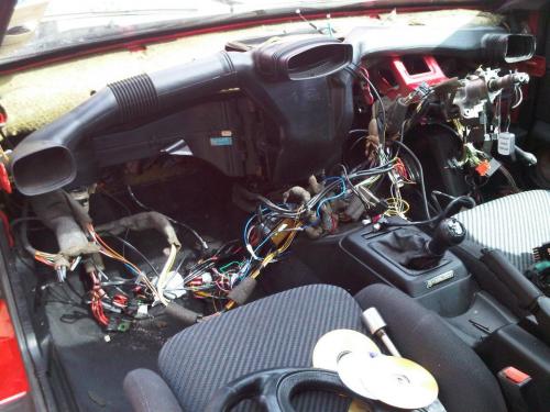

New on here so I've not shown anyone on here this which I carried out last year,so I thought I'd post some pics for you all to browse,

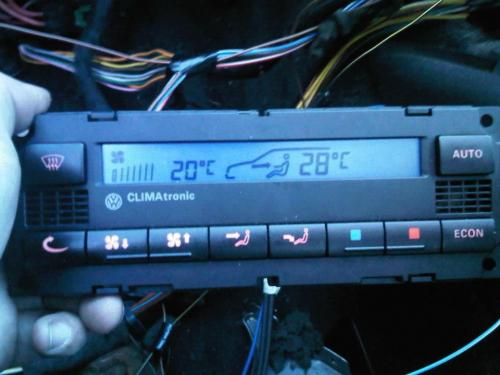

As per, when I got my Corrado it had a list of things wrong with it, Sunroof didn't work, passengers window also didn't work... spoiler worked, some how and the heater controls didn't work and I'm sure anyone on here with late style controls knows the going rate of them in terms of price (£90 or there abouts), so instead I decided to fit a Climatronic unit from a Bora V5.

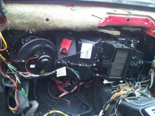

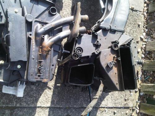

Was a pig of a job to do, had to remount where it bolts up to the bulk head, I did plan to wire the full thing in but it meant cutting in to the ECU wires which I wasn't brave enough to do so it's basically being used as your standard heater controls.
