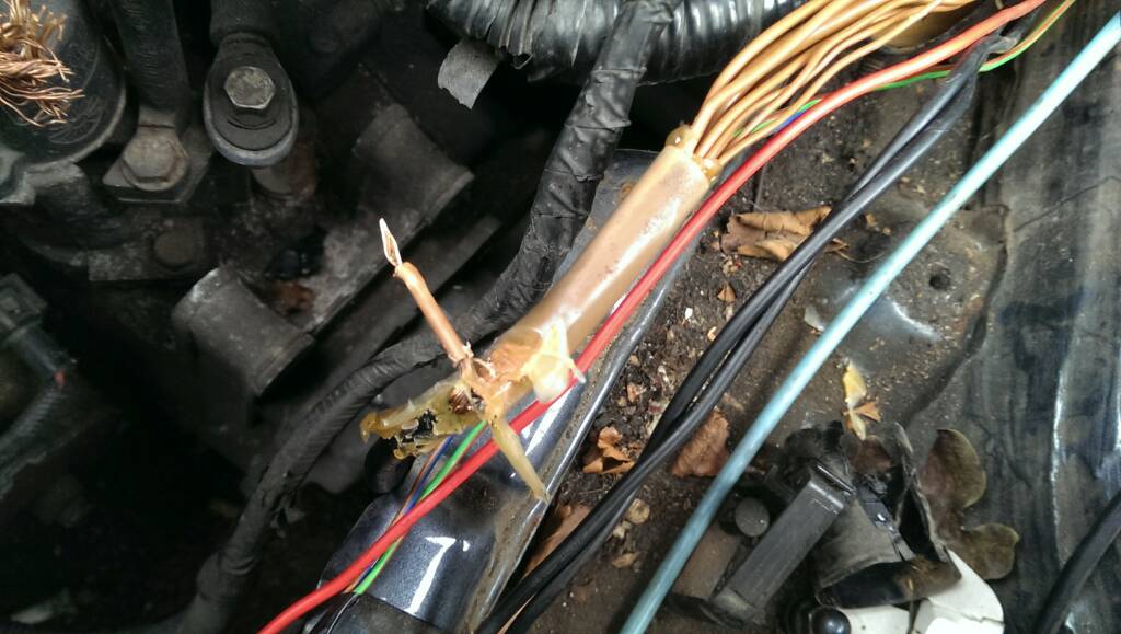

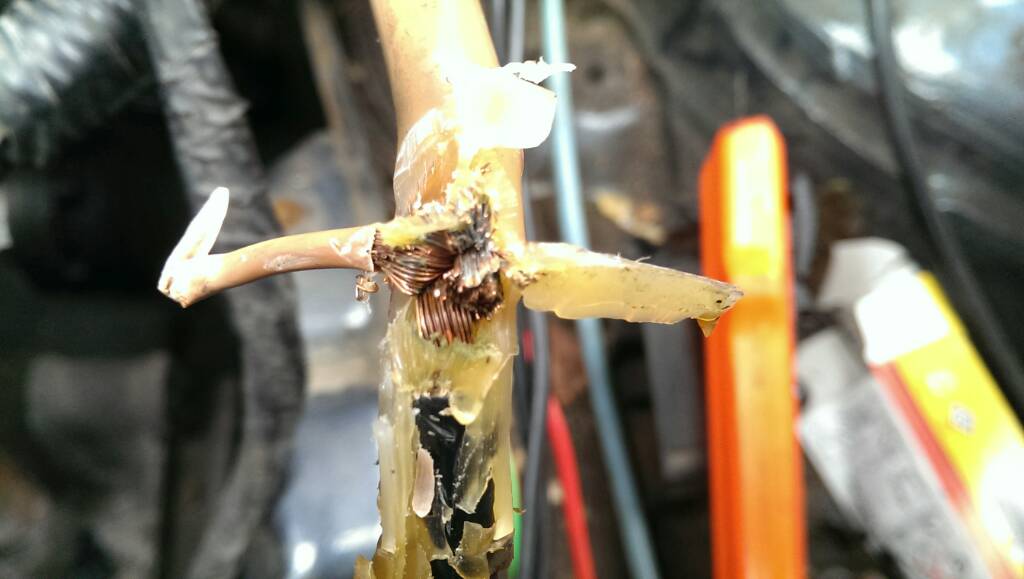

p0u1 14 Posted April 12, 2014 Author Report Share Posted April 12, 2014 Is this really how the ground part of the wiring looms are put together or have I found a previous owners bodge.Sent from my HTC One using Tapatalk Link to post Share on other sites
Lukey. 381 Posted April 12, 2014 Report Share Posted April 12, 2014 That is not standard Link to post Share on other sites
p0u1 14 Posted April 12, 2014 Author Report Share Posted April 12, 2014 Lol I didn't think so, time for a professional bodge lolSent from my HTC One using Tapatalk Link to post Share on other sites
