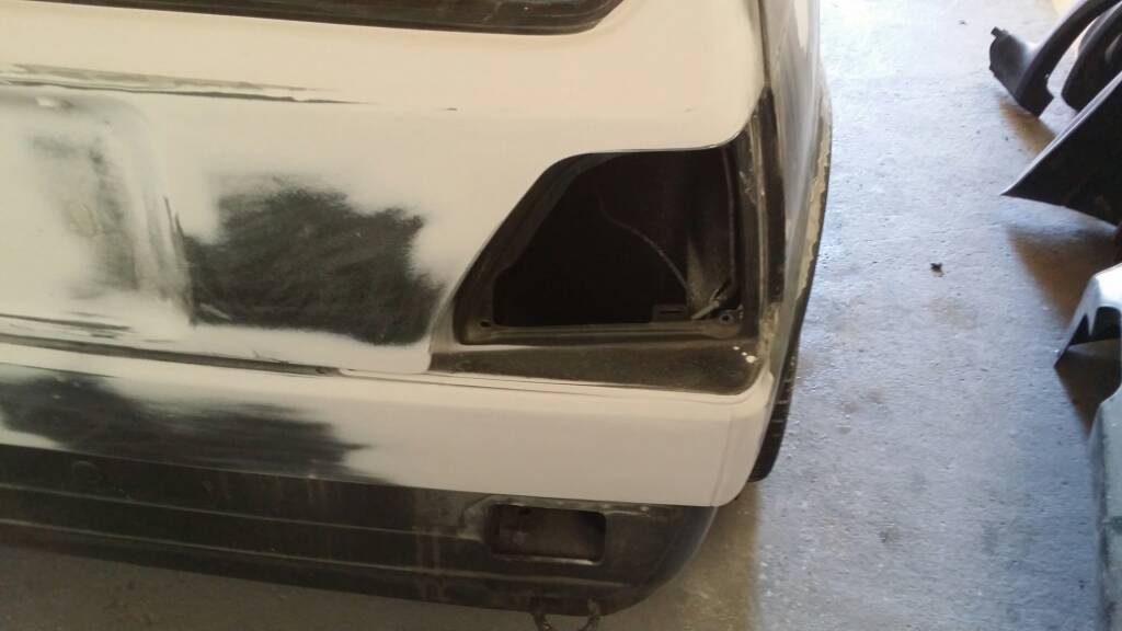

jaks14 174 Posted June 18, 2014 Author Report Share Posted June 18, 2014 Now I'm here lol.... another couple of coats of primer on the bonnet on Friday then I'm gonna pain it on Sunday, with any luck I should have it done, windows back in and all flattened and polished by Wednesday next week.. I've got some banded steels being made at present to 8j front and 9j rears. Gonna do something with them that's gonna be a bit marmite I think, your either gonna think it's different and like or literally hate it hahaha... I will upload some more snaps next week once I've got some paint on it..jimmys oakvr Russvrt and daveyboy 2 Link to post Share on other sites
jaks14 174 Posted June 22, 2014 Author Report Share Posted June 22, 2014 Sunday has arrived... and so did the paint and laquer for the mk2.. got it all taped up this morning and started to lay down the first coat of paint, covered all the primer patches first then moved onto putting a dusty coat across the full car for colour.. The fresh paint I put on it seemed to be so metallicy compared to the paint that was already on, maybe a different variant to what the last painter used.. I have used around 2 litres of colour and around 3 ltrs of anti scratch lacquer to get a high build on the panels so there is enough to flat down and buff up, the car isn't standing me much at all at the minute so I wasn't going for a show standard paint job, a nice flat clean car is all I'm after. Something respectable that I can use as my daily and be a bit of a sleeper for the young boy racers who want a go in their corsas ... I think a dirty derv badge will be next on my list of purchases to go on the back end.. Gonna leave the car another couple of days before I start flatting it down with a block to really give it a good chance to harden off and be cured enough.. I might get the trims and glass cleaned up tommorow. I ended up nearly forgetting to paint my eyebrow for the front. Put it inside the car and only just remembered in time when I had enough paint left in the gun lol.. but it's now done and ready to put on. It's just a plastic panel so is it best to just use some mastic or no nails to attach it to the grill???? It's got no holes or anything for self tappers.. Progress pics will be added the more I get through it...jimmys oakvr daveyboy, D11PS and Bealieboy 3 Link to post Share on other sites

jaks14 174 Posted June 23, 2014 Author Report Share Posted June 23, 2014 Today was productive, got started around 10am and started flatting down the fresh paintwork for a good buff up with the machine polisher.. really happy with the end result being that I done the whole respray in a garage without the conditions of a spray booth.. I used 2000 wet and dry with plenty water and soapy detergent so stop it from sticking and dragging across the panels. After a good flat down I got out the polisher and started with the compound (g3).. keeping it cold so I didn't burn it but went over each panel until there was no visible scratches left from flattening. All I need to do now is the roof which will be tommorow morning and then build it back up again. Number plates on etc... I'm getting a ltr of bumper textured black on Friday to redo my plastic arches, skirts and front and rear bumper tops to give them a new clean fresh look... I'm wanting it to look as original as possible but with some nice little subtle changes.. Any comments or criticisms will be appreciated.. I still need to go back across the full car with a soft sponge mop and some soft high build wax to give the paintwork a really deep shine and look. Then a massive clean inside and out (probably with a jet wash and some snow foam) just to get rid of any excess buffing compound which will be stuck in all the places that I can't get to.I'm looking for someone in the north east to do a full interior valet if anyone has any recommendations, just to give the seats and carpets and nice clean smell and get rid of 23 years of muck and grime which will be in there.. I've still got some major work to be done in the engine bay regarding tidying cables and wires up and trying generally to remove items from the bay so that I can have the holes welded up and them smoothed.. Here are some more pics of how I'm getting on with it...jimmys oakvr daveyboy and D11PS 2 Link to post Share on other sites
