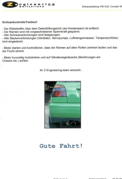

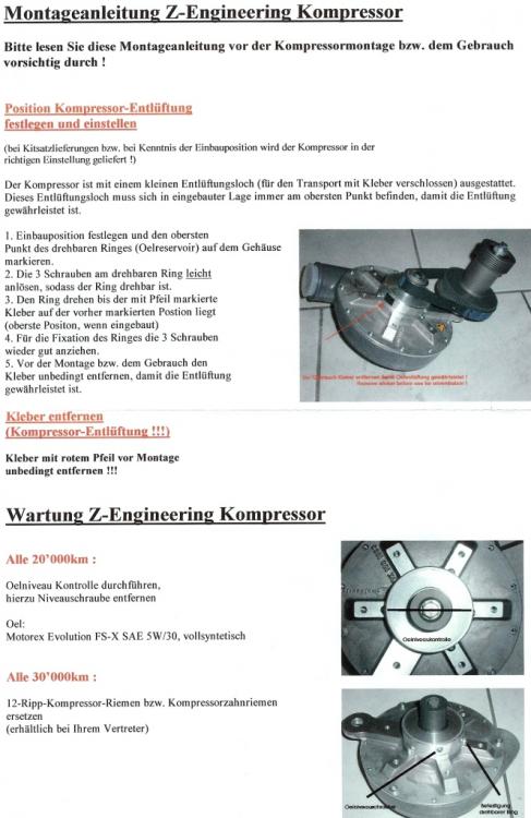

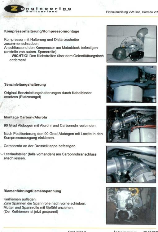

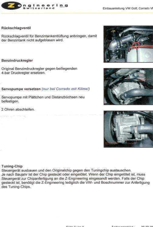

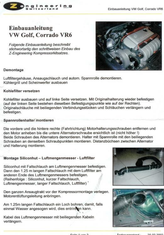

boab3 164 Posted April 8, 2018 Report Share Posted April 8, 2018 One for your library.handy if anyone can help translate Link to post Share on other sites
