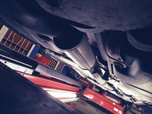

Morbid616 1 Posted November 19, 2015 Author Report Share Posted November 19, 2015 Get the middle silencer removed the exhaust is restrictive on the centre section, decent map panel filter will see it about 230 bhp ft the price difference between these and 32s performance ain't massive difference, plus 4mo look "normal" lol You mean this one? I've thought about removing that one actually, easy project at least. Will it make a huge difference? Link to post Share on other sites
Morbid616 1 Posted November 19, 2015 Author Report Share Posted November 19, 2015 This, I meant. Link to post Share on other sites
mattvr6 133 Posted November 19, 2015 Report Share Posted November 19, 2015 Yea that one where it goes near the diff it get "squashed" lol its 2.5 inch cat side the goes down to 2.3 back box side, mines coming out very soon will make it more free flowing and the noise Link to post Share on other sites
