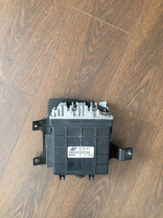

Mk3highline 287 Posted March 2, 2017 Author Report Share Posted March 2, 2017 Hopefully this gets the rust bucket started once I've had the chip swapped over VR6Pete 1 Link to post Share on other sites

Mk3highline 287 Posted March 6, 2017 Author Report Share Posted March 6, 2017 Immobiliser was taken off when I had the map doneGot the new ecu tried and it's firing up now but new ecu needs immobiliser taking offSo ecu was at fault fog-allan 1 Link to post Share on other sites
