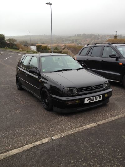

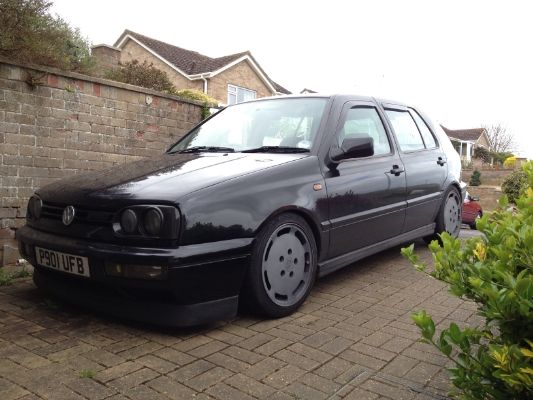

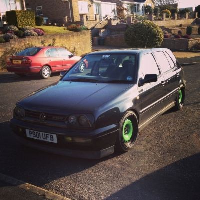

dom.joy 87 Posted November 23, 2015 Report Share Posted November 23, 2015 Swapped my old bora for this a few years ago. How it looked when I got it. The green had to go. Then I tried some new wheels which didn't last long. Added some reclining buckets and took the rear interior out Painted the steels white Stayed like that for quite a while then added a vento front (which I've always wanted) Winter wheels on. Didn't really rate them. Fitted a Vento Splitter and a brake upgrade somewhere along the line Tried some tsw venoms and got a phase 2 veto grille. Venoms didn't work imo. Took it out on track at Players Classic, was so much fun. Had to change Heater Matrix and stripped out Air con along with a few other bits I can't rememeber. Not a fun job. Then some more time passed, some more wheels and it now looks like this. bennyk and Bealieboy 2 Link to post Share on other sites
