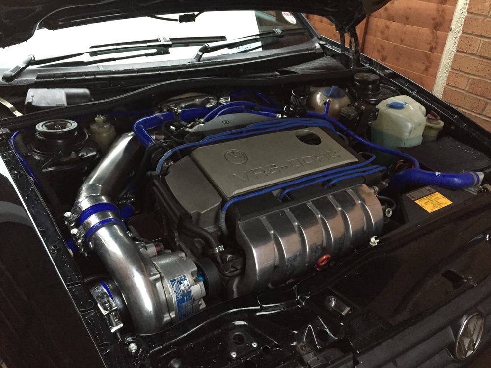

VR6Pete 1,455 Posted January 2, 2017 Report Share Posted January 2, 2017 On 20/12/2016 at 10:55 AM, Smoke666 said: It's not somthing I have the money for at the mo. Just trying to locate all the parts I need and prices for when I am ready. How much do u do ur bits for? Best and cheapest option is to source parts from members as opposed to full kits from suppliers. ASH performance is where I got all my pipe work etc.. from. I also had bits fabricated up. Oil lines supplied by pirtek at a reasonable price. Map supplied by stealth racing. Im using a V1 vortech and achieving 294bhp from my 12v lump. Link to post Share on other sites

mattvr6 133 Posted January 2, 2017 Report Share Posted January 2, 2017 Nice looking bay that, is the body work been done now? Link to post Share on other sites

VR6Pete 1,455 Posted January 3, 2017 Report Share Posted January 3, 2017 18 minutes ago, Smoke666 said: Thanks for all the info. Been thinking of turbo alot over Xmas...sourcing all the parts but want to see if anyone has done a twin turbo. Look at both and see what I think is best for me. Big build! Depends what you want to be honest. If you drive a supercharged VR6 / R32 you will love it, but stick a turbo on then it's a very different story and you'll want a turbo ? Depends on how deep your pockets are and how much time you have to spend on the build. Turbo installs done right are reliable - spacer plates / or low comp setup and also intercooler, injectors, management, pipe work, down pipes etc... supercharger literally bolt on and I've almost got 300bhp on a stock lump that's reliable - yep costs a lot in fuel but seriously fun and addictive Link to post Share on other sites
