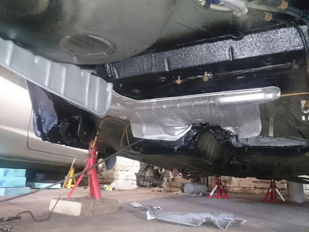

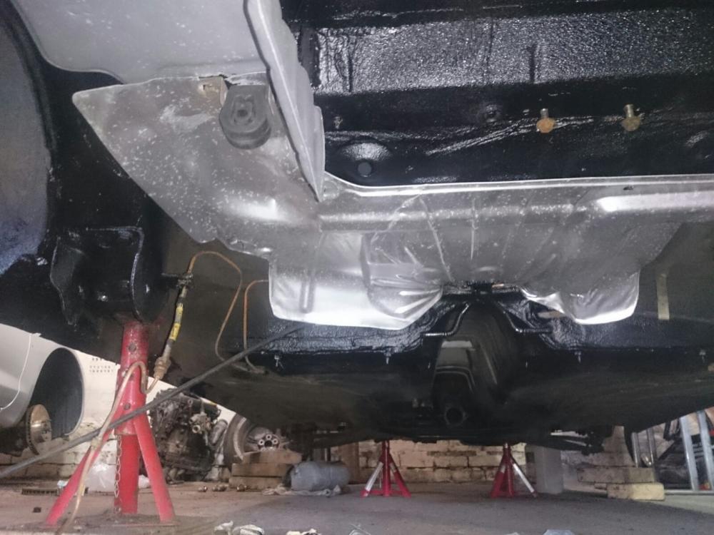

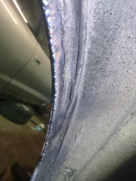

fog-allan 30 Posted January 31, 2017 Author Report Share Posted January 31, 2017 Thanks very much, more progress yesterday, unfortunately due to work family I only manage 1 or 2 days each month so it's been slow. Rear arches cut, welded, sealed. Link to post Share on other sites

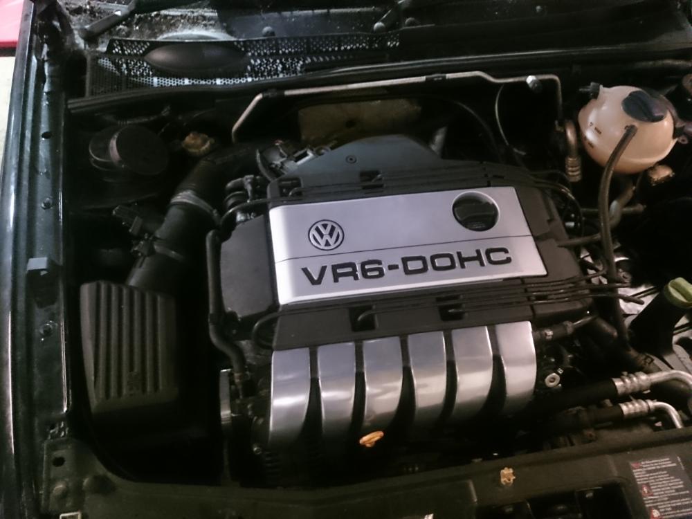

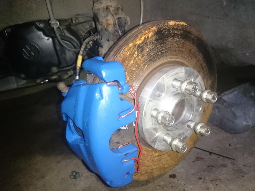

fog-allan 30 Posted January 31, 2017 Author Report Share Posted January 31, 2017 (edited) Front Calipers back on, nice new seals n refresh on paint. Engine back together after doing timing chains, clutch and an as yet untested v5 EBS Gearbox... It better work I've put £40 worth of MT90 in it!!! Edited January 31, 2017 by fog-allan Photos VR6Pete 1 Link to post Share on other sites

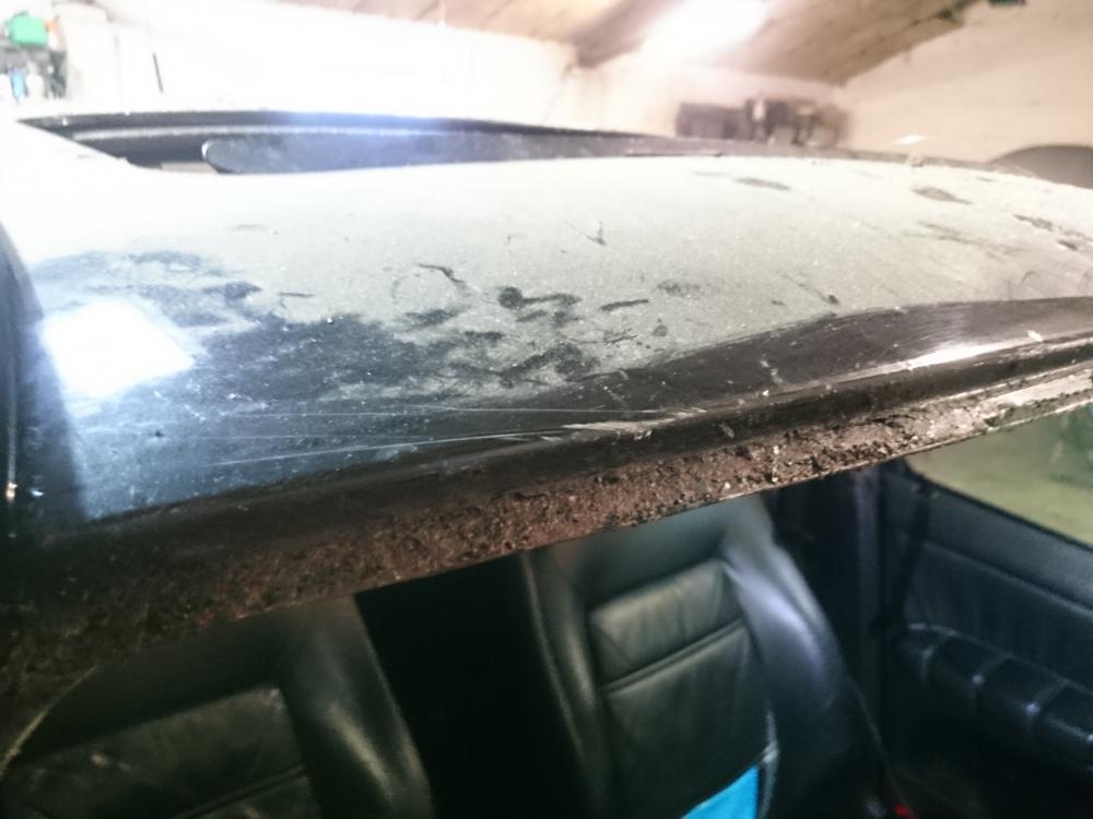

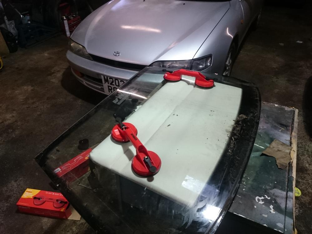

fog-allan 30 Posted March 2, 2017 Author Report Share Posted March 2, 2017 Update- windscreen out this week, took my time with some 0.6mm mig wire and two handles (spanners). Screen had slight leak so needed to investigate. Found this! Thankfully in nick of time. Anybody have an input to the best way to clean and prep before I put screen back in? Was thinking wire wheel, rust treatment then primer...? Link to post Share on other sites
VR6CABBS 1,311 Posted March 3, 2017 Report Share Posted March 3, 2017 Yep I'll go with that. Take it right back and remove as much as you can then a few rust treatments before a couple of coats of black primer. Link to post Share on other sites
fog-allan 30 Posted March 3, 2017 Author Report Share Posted March 3, 2017 Thank you, a second opinion is always reassuring! I'm doing most things as a first time so little unsure sometimes.. Link to post Share on other sites

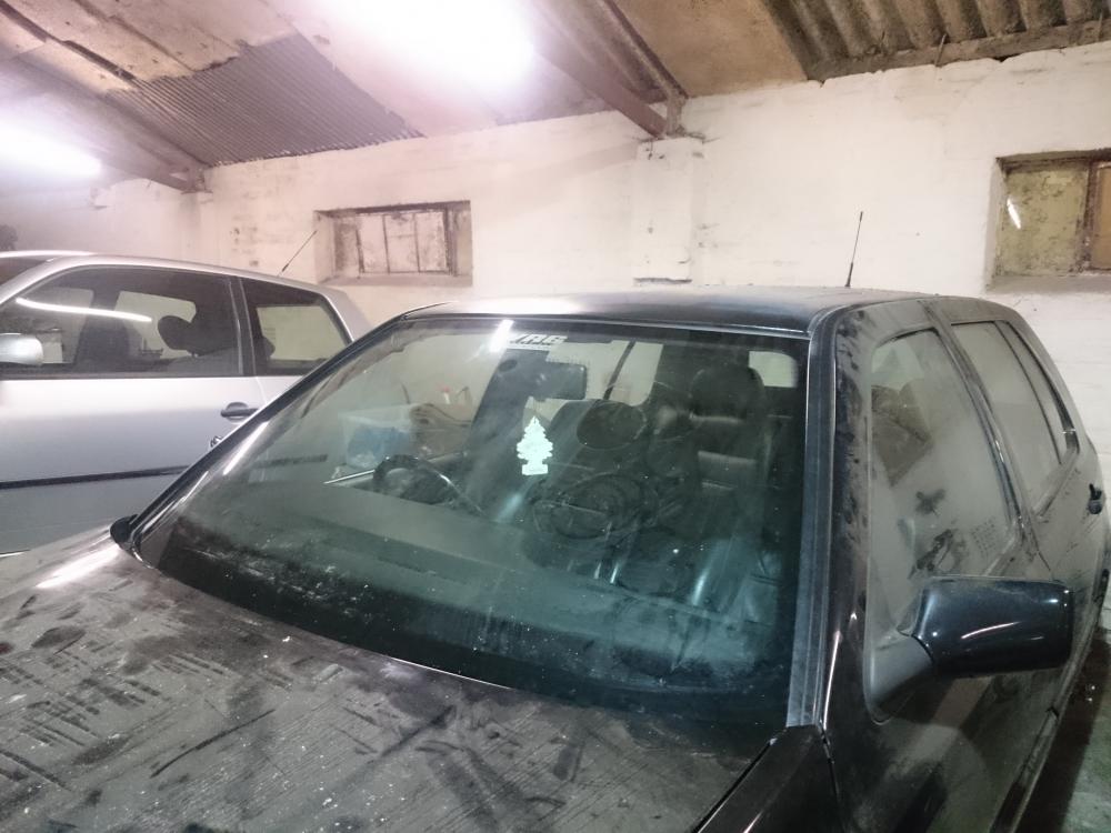

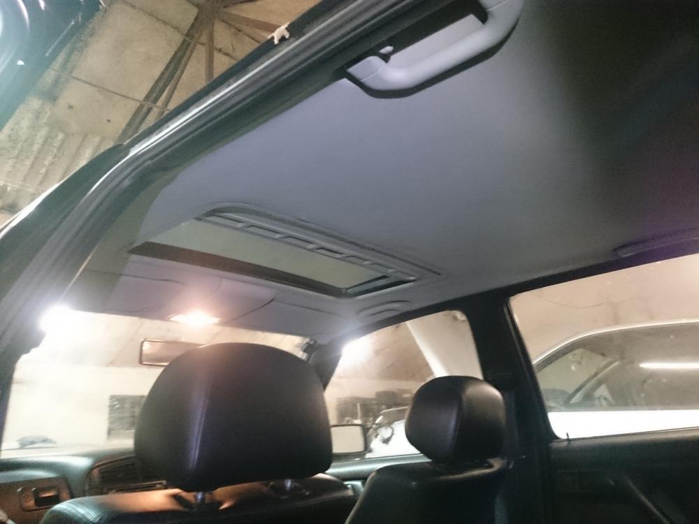

fog-allan 30 Posted May 11, 2017 Author Report Share Posted May 11, 2017 Progress update... Windscreen, roof lining and trim all back in.. Was definitely a lot easier getting lining out, not a job I'd be in a hurry to repeat! Slight issue with screen height, my scuttle panel doesn't quite seal with the screen? Anybody any thoughts on a fix for this? Seal sits about 3mm proud of actually contacting the screen! Not enough height on windscreen sealant but it's in now so it will be staying put. Link to post Share on other sites
