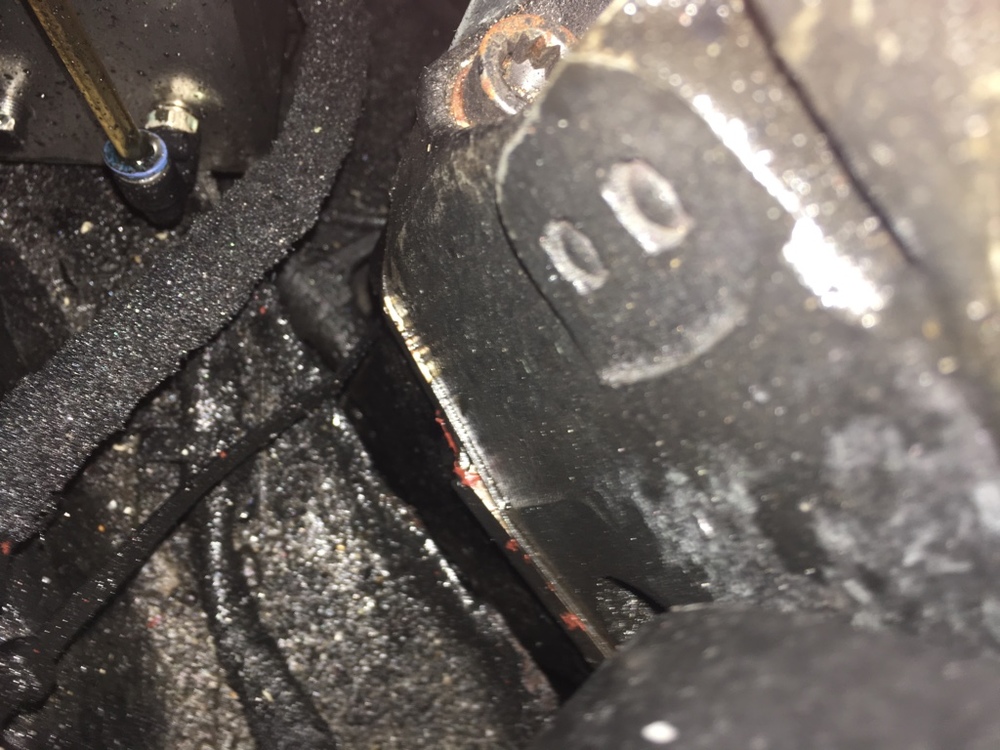

Brannonc4 27 Posted March 8, 2017 Report Share Posted March 8, 2017 As title suggests I believe I have headgasket failure , over the last few days I've noticed when I've been driving for around 20mins I can see the temp gauge getting up to around 110 degrees, the first time it happened I pulled over and saw steam coming from the expansion tank saw that the cap wasn't sitting flush so bought another and it seems to have fixed the problem, however it's leaking oil from just below the crankcase where big block meets upper - it's not a lot but I can see residue where it's come out.(I've posted a photo not the best angle) I'm also not getting any hot air into the cabin is this synonymous with head gasket failure or blocked rad? I've checked oil cap and no creamy sludge on it also checked dipstick, ran car without expansion tank cap to see if it started bubbling but it didn't. Any help would be truly appreciated! UPDATE* It's in the garage currently and they're going to inspect it tomorrow (I can hear them scrambling for the calculator already!) lol Link to post Share on other sites

Brannonc4 27 Posted March 30, 2017 Author Report Share Posted March 30, 2017 4 minutes ago, VR6 Supercharged said: Did you get to the bottom of the overheating issue? Hi mate, well I believe so! I followed your advice and checked the radiator all seemed fine, also tried the cardboard to see anything under it but nothing - I did however notice a squeal from the engine bay after it warmed up and my supercharger wasn't completely on tight, and i believe that was the source of the noise, anyway... onto the important bit! I took it to RK Engineering in St Agnes who looked it over, basically HG had blown but not going into cylinders (could see small amount of residue coming from block after spraying compressed air, he then tighten the nearest head bolt to the leak which he said didnt look like it had been done up enough, after that he put K-seal through the system and ran it for a bit, I am now no longer losing coolant and can feel the power returning slightly, His prognosis was new HG sooner or later, also SC stripped with new belt and smaller pulleys and boosted, also advised Spacer with mk4 head gasket to lower compression, and finally because my 3rd gear is starting to mash up maybe a v5 or touran 6 speed gearbox. So thats where I'm at currently, He'd put the car up in the air and told me it was generally in good knick but with a lot of these show cars (or ex show cars) they haven't been given the service they require. Ive been told its about a 2 month wait to get the work done but he can do the gearbox earlier VR6 Supercharged 1 Link to post Share on other sites
